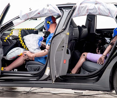

View of the vehicle after the crash showing the airbags and damage to the occupant compartment.
The rear passenger dummy's head came close to contacting the front seatback, which increases the risk of head injuries.
Rear passenger dummy injury values indicate a low risk of injury to the chest and a moderate risk of injury to the head or neck. During the crash, the shoulder belt remained in an ideal position on the dummy’s chest.
The rear passenger dummy's lap belt remained in the ideal position on the pelvis. Technical measurements for this test
