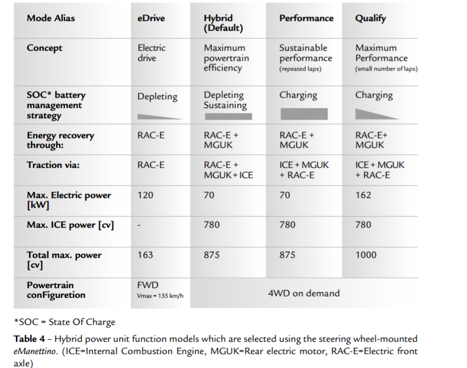

The car’s name encapsulates the true significance of all that has been achieved in terms of performance. The reference to the 90th anniversary of the foundation of Scuderia Ferrari
90° V8 turbo engine capable of delivering 780 cv
220 cv is delivered by three electric motors, known as the MGUK (Motor Generator Unit, Kinetic)(one at the rear and two on the front axle)
1,000 cv total
weight-to-power ratio of 1.57 kg/cv
starting by increasing its capacity from 3,902 cc to 3,990 cc thanks to a larger bore of 88 mm.
new 8-speed dual-clutch transmission
first Ferrari sports car to be equipped with 4WD
1,570 kg
390 kg of downforce at 250 km/h
0 -100km/h in 2.5 sec.
0 -200km/h in 6.7 sec.
When the internal combustion engine is turned off, the two independent front motors deliver a maximum speed of 135 km/h with longitudinal acceleration of ≤0.4 g.
