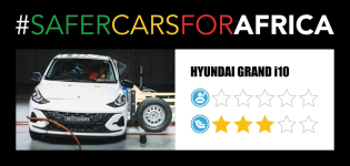

Hyundai i10 Latin Ncap - zero estrelas
https://www.globalncap.org/news/hyundai-falls-short-with-zero-star-result-in-africa
The crash test report noted:
  • Concerning weak protection for the driver’s chest in frontal impact test.
  • High risk of non-recoverable chest injuries, leading to strong probability of life-threatening injuries for the adult in the side impact test. Maximum allowed injury levels in a critical body region such as the chest were exceeded, resulting in zero points for adult occupant protection.
  • In the frontal impact test, the bodyshell and footwell were rated as unstable and could not withstand further loading.
  • No standard side body or head protection and Seat Belt Reminder (SBR) only for the driver.
  • No standard ESC.
