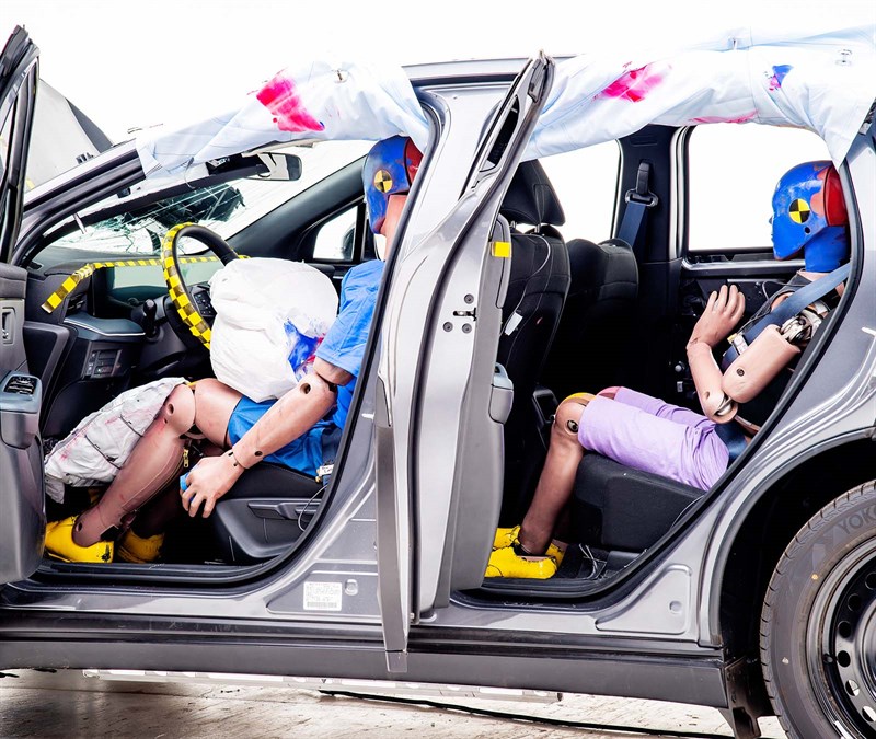

Nissan Leaf 2026 IIHS crash test
https://www.iihs.org/ratings/vehicl...back/2026#moderate-overlap-front-updated-test
Small overlap front
The small overlap front evaluation consists of a driver-side and a passenger-side component. If the results of the two evaluations differ, then the combined small overlap rating is equal to the lower rating. Driver-side
Tested vehicle: 2026 Nissan Leaf SV+ EV 4-door
Rating applies to 2026 models
The Nissan Leaf was redesigned for the 2026 model year. Driver-side small overlap frontal ratings are assigned by the Institute based on a test of a 2026 Leaf conducted by Nissan.

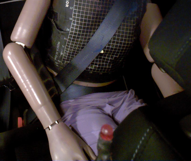

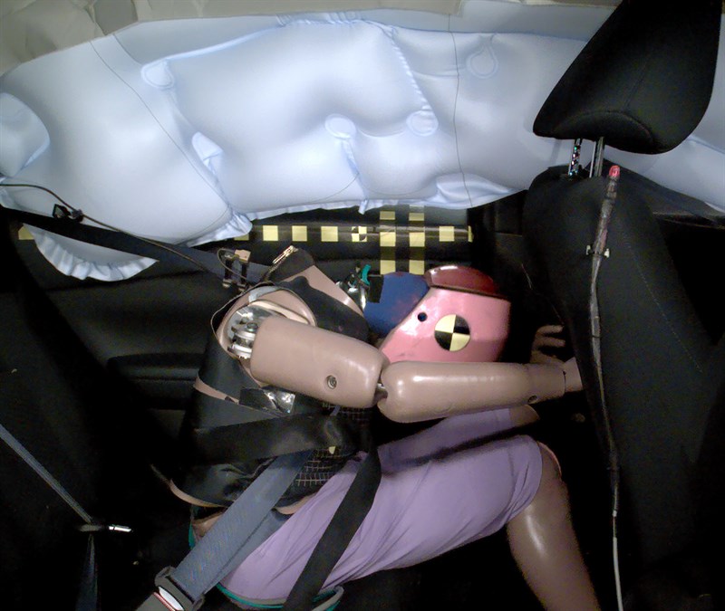

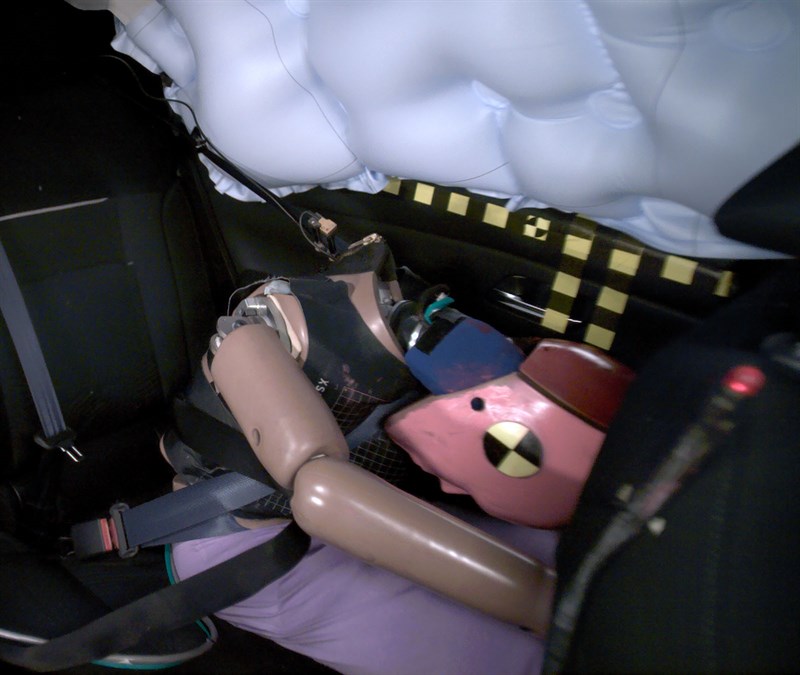

View of the vehicle after the crash showing the airbags and damage to the occupant compartment.
The rear passenger dummy's head came close to contacting the front seatback, which increases the risk of head injuries.
Rear passenger dummy injury values indicate a moderate risk of injury to the head or neck and chest. During the crash, the shoulder belt remained in an ideal position on the dummy’s chest.
The rear passenger dummy's lap belt remained in the ideal position on the pelvis. Technical measurements for this test
