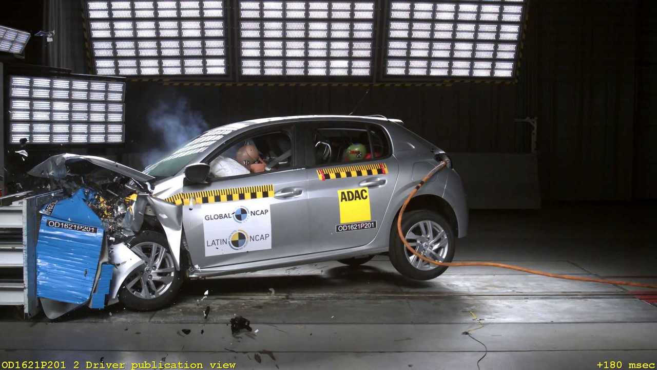

Peugeot 208
https://www.latinncap.com/en/result/156/peugeot-208-+-4-airbags
The Peugeot 208, manufactured in Argentina, with 2 frontal airbags, 2 side body airbags and Electronic Stability Control (ESC) as standard equipment, achieved two stars under Latin NCAP’s latest protocols. The popular compact model achieved 51.53% in Adult Occupant box, 54.92% in Child Occupant box, 54.13% in Pedestrian Protection and Vulnerable Road Users box and 55.81% in Safety Assist box.
The 208 was tested in frontal impact, side impact, whiplash, pedestrian protection, ESC and ‘Moose’ test. The model showed an acceptable performance in the frontal impact and good side impact for the adult protection thanks to its restraints systems. Whiplash protection was good, the car meets rear impact UNR32 regulation requirements and offers a rescue sheet according to Latin NCAP requirements. The bodyshell and footwell area were rated as unstable. The lack of standard side head protection airbags limited the car scoring. In order to score AEB points, cars need full passive protection and without the curtain airbags the 208 would not be able to score AEB points, technology which is available in the 208 versions.

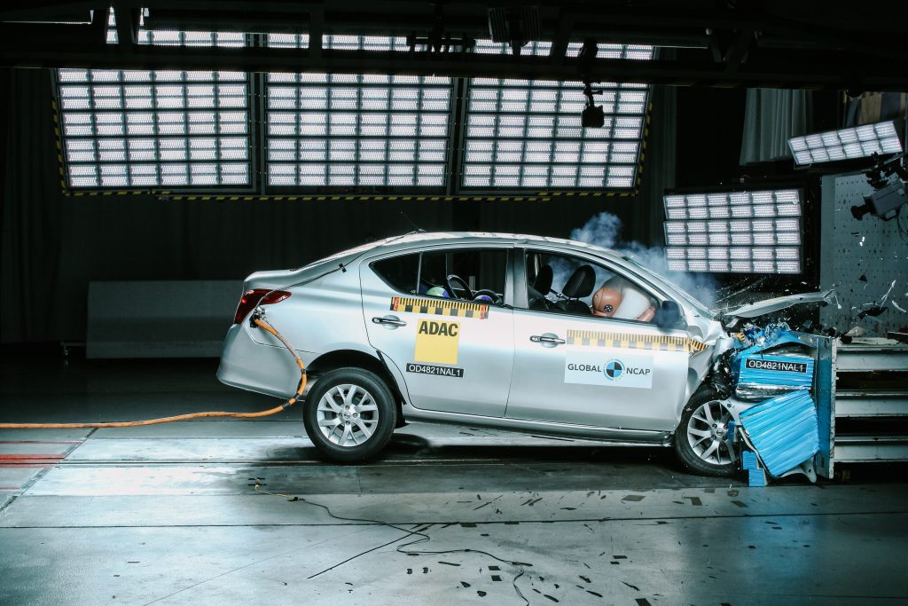

Nissan Almera
https://static1.squarespace.com/sta...030722066/Nissan+Almera+2021+-+fact+sheet.pdf
Esse 208 latino não será uma espécie de "207+"?
Não, é a carroçaria nova mas tal como no caso do Renault Zoe 2021 quando foi testado pelo Euroncap, também a Peugeot retirou equipamente de segurança ao 208 Latino Americano
The bodyshell and footwell area were rated as unstable. The lack of standard side head protection airbags limited the car scoring. Also during the dynamic test the rear seat backrest unlatched affecting the 3 years old dummy head excursion which could lead to points reduction for the head. The mislatching is investigated and was explained by poor user communication. Some actions were already taken by Peugeot in improving the colour for handle mislatching warning and also in reviewing the backrest system.
After Peugeot decided to improve the car to warn consumers properly, in order to prevent rear seat backrest mislatching, a second vehicle with the improvements included was tested. In this new test the rear seat backrest remained in its position during the crash leading to better results for child occupant protection. It is very likely that with side head protection as standard the results would dramatically improve. Latin NCAP offered Peugeot to test better equipped versions of the 208 but the manufacturer declined the offer.

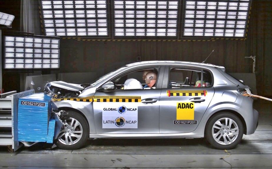

As marcas pelos vistos começam, aborrifar-se para os Ncap. A Peugeot bem podia ter re testado um 208 com airbags de cortina e o carro facilemnte teria, uma pontuaçã melhor. Contudo o facto de a carroçaria ser considerada instável, pode ser prenuncio de difrenças ao nível da construção em relação as variantes Europeias
