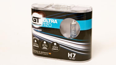

GT Ultra 120
11
Promising ‘just’ 120 per cent, it was no surprise to see the GT Ultra, which is part of online retailer Powerbulbs’ offering, at the lower end of the results. The difference could be seen in the tunnel, with the beam lacking the brightness of the best, while the cut off wasn’t as well defined. Beam length was under 89 metres and the FOM rating of 87 was more than 10 points behind the next bulb and almost 40 off our winner.
